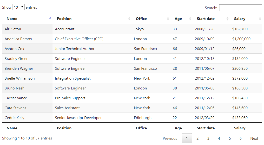

$(document).ready( function () {
    $('#myTable').DataTable();

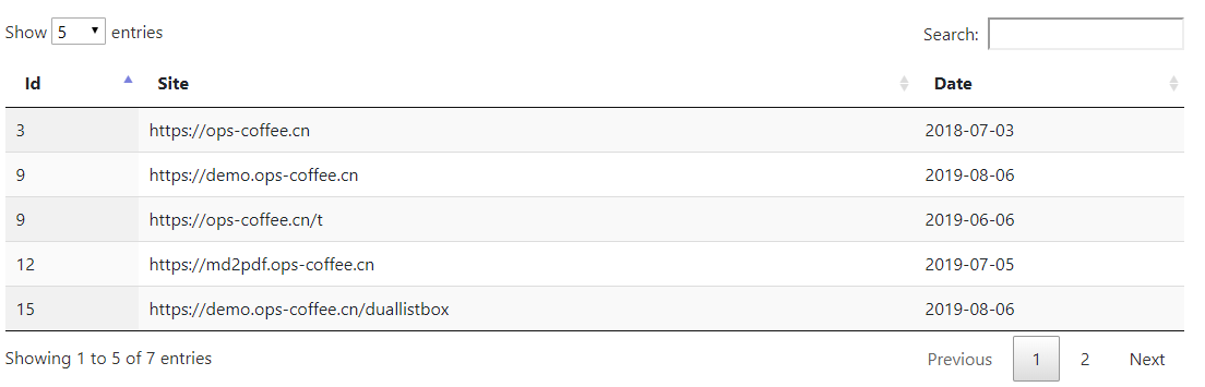

  1. 完成以上两步可以看到页面效果如下

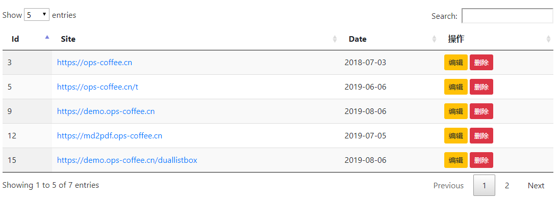

当然也可以通过columns在表格末尾添加一列以实现编辑、删除的按钮展示
"columns": [
    {"data": "id", "title":"Id"},
    {        "data": "site",
        "title":"Site",        "render": function (data, type, row) {          return '<a href='+data+' target="_blank">'+data+'</a>'
    {"data": "date", "title":"Date"},
      "data": "id",      "title": "操作",      "render": function (data, type, row) {        return '<a href="#update/'+row.id+'/" class="btn btn-warning btn-sm">编辑</a> ' +               '<a href="#delete/'+row.id+'/" class="btn btn-danger btn-sm">删除</a>'
最终呈现结果如下图

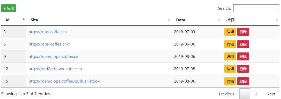

我们想把右上角的每页显示条数控件换成添加按钮的话可以这样写
$('#myTable-x').dataTable({    "dom": '<"#add-btn.toolbar">frtip'})
$("#add-btn.toolbar").html(  '<button href="#add" class="btn btn-success btn-sm"> + 添加</button>')
遇到样式问题,需要添加css
<style type="text/css">
  .toolbar {float:left}</style>
这样就完美实现了

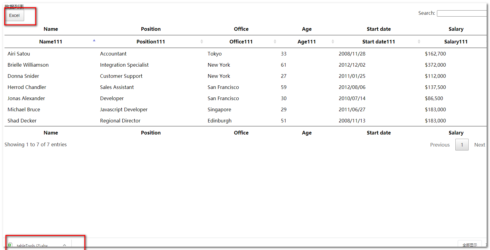

导出
https://datatables.net/download 官方下载
导出Excel
<!DOCTYPE html><html lang="en"><head>
    <meta charset="UTF-8">
    <title>tableTools</title>
    <!-- jQuery -->
    <script type="text/javascript" charset="utf8" src="http://code.jquery.com/jquery-1.10.2.min.js"></script>
    <!--datatables 的样式和导出excel的js-->
    <link rel="stylesheet" type="text/css" href="https://cdn.datatables.net/v/dt/jszip-2.5.0/dt-1.10.21/b-1.6.2/b-flash-1.6.2/b-html5-1.6.2/datatables.min.css"/>
    <script type="text/javascript" src="https://cdn.datatables.net/v/dt/jszip-2.5.0/dt-1.10.21/b-1.6.2/b-flash-1.6.2/b-html5-1.6.2/datatables.min.js"></script>
    <script>
        $(document).ready(function () {
            $('#myTable').DataTable({                dom: 'Bfrtip',                buttons: [                    'excelHtml5',
        });    </script></head><body><div class="col-md-12 col-sm-12">
    <!-- BEGIN EXAMPLE TABLE PORTLET-->
    <div class="portlet box blue-hoki">
        <div class="portlet-title">
            <div class="caption">
                <i class="fa fa-list"></i>数据列表            </div>
            <div class="tools">
            </div>
        </div>
        <div class="portlet-body">
            <table id="myTable" class="table table-striped table-bordered table-hover"
                   style="width:100%">
                <thead>
                <tr>
                    <th>Name</th>
                    <th>Position</th>
                    <th>Office</th>
                    <th>Age</th>
                    <th>Start date</th>
                    <th>Salary</th>
                </tr>
                <tr>
                    <th>Name111</th>
                    <th>Position111</th>
                    <th>Office111</th>
                    <th>Age111</th>
                    <th>Start date111</th>
                    <th>Salary111</th>
                </tr>
                </thead>
                <tbody>
                <tr>
                    <td>Airi Satou</td>
                    <td>Accountant</td>
                    <td>Tokyo</td>
                    <td>33</td>
                    <td>2008/11/28</td>
                    <td>$162,700</td>
                </tr>
                <tr>
                    <td>Brielle Williamson</td>
                    <td>Integration Specialist</td>
                    <td>New York</td>
                    <td>61</td>
                    <td>2012/12/02</td>
                    <td>$372,000</td>
                </tr>
                <tr>
                    <td>Herrod Chandler</td>
                    <td>Sales Assistant</td>
                    <td>San Francisco</td>
                    <td>59</td>
                    <td>2012/08/06</td>
                    <td>$137,500</td>
                </tr>
                <tr>
                    <td>Jonas Alexander</td>
                    <td>Developer</td>
                    <td>30</td>
                    <td>2010/07/14</td>
                    <td>$86,500</td>
                </tr>
                <tr>
                    <td>Shad Decker</td>
                    <td>Regional Director</td>
                    <td>Edinburgh</td>
                    <td>51</td>
                    <td>2008/11/13</td>
                    <td>$183,000</td>
                </tr>
                <tr>
                    <td>Michael Bruce</td>
                    <td>Javascript Developer</td>
                    <td>Singapore</td>
                    <td>29</td>
                    <td>2011/06/27</td>
                    <td>$183,000</td>
                </tr>
                <tr>
                    <td>Donna Snider</td>
                    <td>Customer Support</td>
                    <td>New York</td>
                    <td>27</td>
                    <td>2011/01/25</td>
                    <td>$112,000</td>
                </tr>
                </tbody>
                <tfoot>
                <tr>
                    <th>Name</th>
                    <th>Position</th>
                    <th>Office</th>
                    <th>Age</th>
                    <th>Start date</th>
                    <th>Salary</th>
                </tr>
                </tfoot>
            </table>
        </div>
    </div></div></body></html>
    <!-- jQuery -->
    <!--PDF-->
    <script type="text/javascript" src="https://cdnjs.cloudflare.com/ajax/libs/pdfmake/0.1.36/pdfmake.min.js"></script>
    <script type="text/javascript" src="https://cdnjs.cloudflare.com/ajax/libs/pdfmake/0.1.36/vfs_fonts.js"></script>
    <script type="text/javascript" src="https://cdn.datatables.net/v/dt/dt-1.10.21/b-1.6.2/b-html5-1.6.2/datatables.min.js"></script>
    <script>
            $('#myTable').DataTable({                dom: 'Bfrtip',                buttons: [                    'excelHtml5',                    'pdfHtml5',
            <div class="tools">
            </div>
        </div>
                   style="width:100%">
                <thead>
                <tr>
                    <th>Name</th>
                    <th>Position</th>
                    <th>Office</th>
                    <th>Age</th>
                    <th>Start date</th>
                    <th>Salary</th>
                </tr>
                <tr>
                    <th>Name111</th>
                    <th>Office111</th>
                    <th>Age111</th>
                    <th>Salary111</th>
                </tr>
                </thead>
                <tbody>
                <tr>
                    <td>Airi Satou</td>
                    <td>Accountant</td>
                    <td>Tokyo</td>
                    <td>33</td>
                    <td>2008/11/28</td>
                    <td>$162,700</td>
                </tr>
                <tr>
                    <td>New York</td>
                    <td>61</td>
                    <td>2012/12/02</td>
                    <td>$372,000</td>
                </tr>
                <tr>
                    <td>59</td>
                    <td>2012/08/06</td>
                    <td>$137,500</td>
                </tr>
                <tr>
                    <td>Developer</td>
                    <td>30</td>
                    <td>2010/07/14</td>
                    <td>$86,500</td>
                </tr>
                <tr>
                    <td>Edinburgh</td>
                    <td>51</td>
                    <td>2008/11/13</td>
                    <td>$183,000</td>
                </tr>
                <tr>
                    <td>Singapore</td>
                    <td>29</td>
                    <td>2011/06/27</td>
                    <td>$183,000</td>
                </tr>
                <tr>
                    <td>New York</td>
                    <td>27</td>
                    <td>2011/01/25</td>
                    <td>$112,000</td>
                </tr>
                </tbody>
                <tfoot>
                <tr>
                    <th>Name</th>
                    <th>Position</th>
                    <th>Office</th>
                    <th>Age</th>
                    <th>Start date</th>
                    <th>Salary</th>
                </tr>
                </tfoot>
            </table>
        </div>

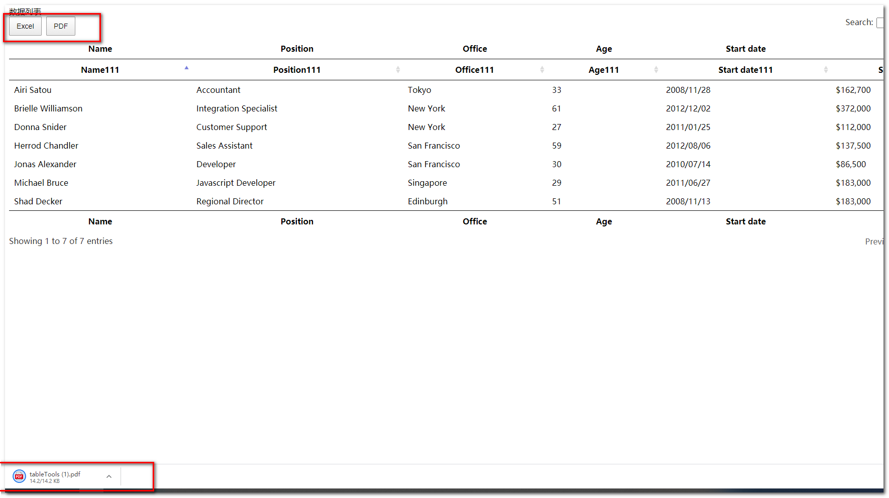

运行效果
导出按钮的配置
例:
dom: 'Bfrtip',buttons: [
{    //按钮    extend: "copy",    //按钮名称    text: '复制',    //按钮的class名称
    className : 'export-btn'},
{    extend: "excelHtml5",    text: '导出excel',
{    extend: "copy",    text: '导出pdf',
    },    //'copy', 'excelHtml5','pdfHtml5'],
所有配置选项
https://datatables.net/reference/option/buttons.buttons
导出设置
https://datatables.net/extensions/buttons/examples/html5/outputFormat-function.html
参考文章:https://ops-coffee.cn/s/mx2gjLmO7jHKagGsWF6eJw
